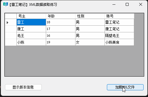

5.2、效果演示

6.2、代码如下
①:引入命名空间
using System.Xml;
②:加载XML文件
private void btnLoadXml_Click(object sender, EventArgs e){    //创建XML文档操作对象    XmlDocument objDoc = new XmlDocument();    //加载XML文件到文档对象中    objDoc.Load("F:\\F004-C#\\B002_xiangmu\\A002_FileOperation\\LeiGongXMLDemo\\LeiGongXMLFile1.xml");    //获取XML文档根目录    XmlNode xmlNode = objDoc.DocumentElement;    //创建对象集合    List<Author> list = new List<Author>();    //遍历根节点(根节点包含所有节点)    foreach(XmlNode node in xmlNode.ChildNodes)    {if(node.Name=="Author"){    Author author = new Author();    foreach(XmlNode xmlNode1 in node)//遍历子节点    {switch(xmlNode1.Name){    case "AutName":author.AutName = xmlNode1.InnerText;break;    case "AutAge":author.AutAge = Convert.ToInt16(xmlNode1.InnerText);break;    case "Gender":author.Gender = xmlNode1.InnerText;break;    case "Account":author.Account = xmlNode1.InnerText;break;}    }    list.Add(author);}    }    this.dgvAutList.DataSource = list;}

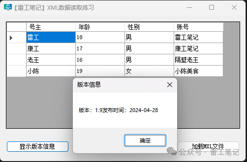

③:显示版本信息
private void btnShowVersion_Click(object sender, EventArgs e){    //创建XML读取器    XmlTextReader xmlTextReader = new XmlTextReader("F:\\F004-C#\\B002_xiangmu\\A002_FileOperation\\LeiGongXMLDemo\\LeiGongXMLFile1.xml");    string info = string.Empty;    //循环查询    while (xmlTextReader.Read())    {if(xmlTextReader.Name== "EdiInfo"){    info = "版本:" + xmlTextReader.GetAttribute("ediNO") + "发布时间:" + xmlTextReader.GetAttribute("ediTime");    break;}    }    MessageBox.Show(info,"版本信息");}
