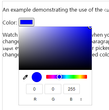

通过跟踪 change 和 input 事件,将新颜色应用到文档中的每个 <p> 元素。

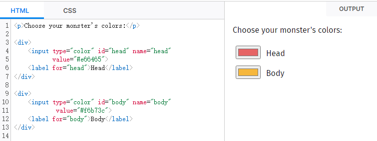

HTML
<p>
  An example demonstrating the use of the
  <code>&lt;input type="color"&gt;</code> control.
</p>
<label for="colorWell">Color:</label>
<input type="color" value="#ff0000" id="colorWell" />
<p>
  Watch the paragraph colors change when you adjust the color picker. As you
  make changes in the color picker, the first paragraph's color changes, as a
  preview (this uses the <code>input</code> event). When you close the color
  picker, the <code>change</code> event fires, and we detect that to change
  every paragraph to the selected color.

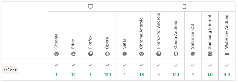

兼容性
原文:https://developer.mozilla.org/zh-CN/docs/Web/HTML/Element/Input/color
